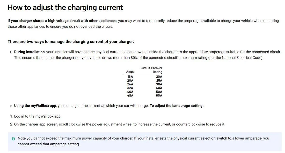

@submatrix Wallbox charging rate can be limited (below circuit's rated capacity). See clip from Wallbox knowledge base site.

I'll have to do more testing the next time I visit them. This is just what my dad told me based on what he observed in the Wallbox app, which I presume has logs of past charging sessions. As far as I'm aware he didn't apply any limit to the Wallbox itself.
