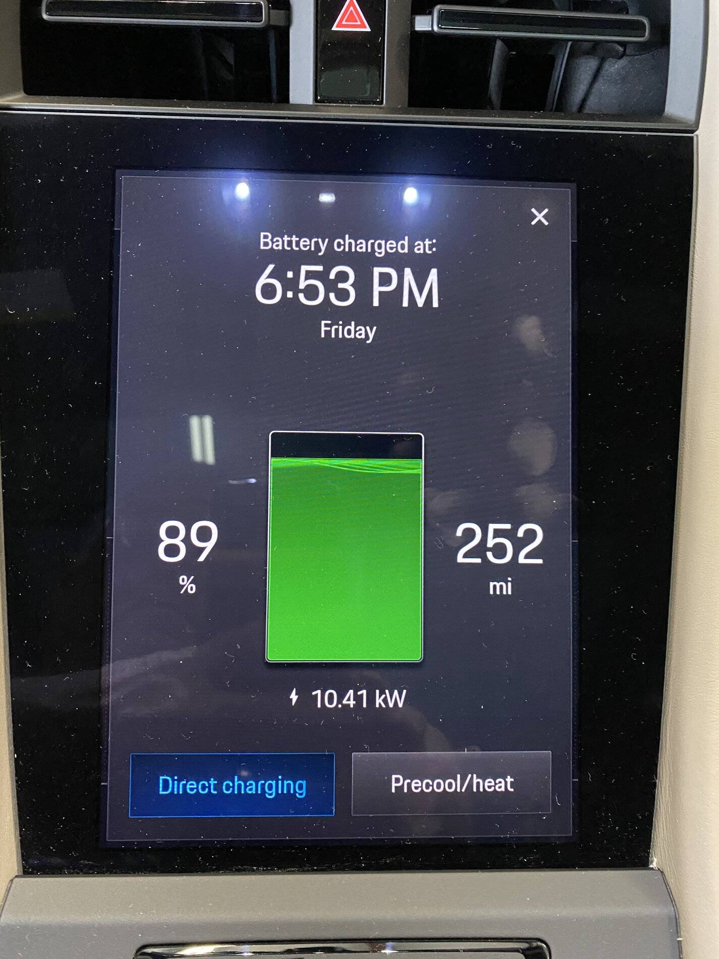

Thanks to this thread I ended up with the right charger for my needs. Didn’t end up clicking the 19.2kw option which actually would have only costed me another $3000 incl the updated charger, but frankly I don’t need those 3-4 hours of quicker charger since my daily use is < 20 miles.
Ended up with the 11kw charging option instead:
718 EV Electric Cayman Boxster [US] - Over the Top - the well equipped EV home garage…for those that wish to "over do it"… 0FF22586-AD48-42C1-8442-CDD4DB10FF54
now I just need my Tacan...

Does anyone know of a charger that would allow for a variable charging rate?
I was thinking that for the health of the battery, if I am not in a rush, I would prefer to do daily charging at a much lower rate (3kw) overnight, and when I need to get a quicker charge, or need to charge a lot, to set it to 11kw and charge quicker.
This would be for the daily charging I do (e.g. going from 50-60 to 85).
Or do you think that it really makes no difference in charging often at 3kw vs. 9 or even 11?
Scandinavian
Peter
Nov 3, 2019
France
Taycan T, Aston Martin DB9, Porsche 996 C4 Cab, i4
I do not think it makes any difference at all when charging with AC up to 11 kW. There have been many Tesla’s that have charged daily with 11 kW.
secondly, if you really want to do this, you can simply dial down the ampers on the PMCC! I am not sure how low you can go but cerainly down to say 6 ampere with a single phase connection.

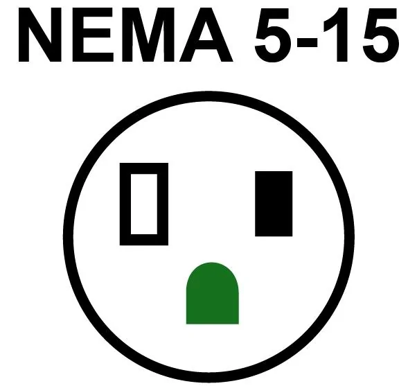

Level 1 - Inadequate but some people try - NEMA 5-15 Household Outlet - 1.44 kW - 120 volts @ 15 amps (12 amps for charging)
(70 hours for a full charge from near zero % battery).​
this can be done, and for 8-10 hours over night you can add 12-14 kWh - which is about 50 miles daily driving range - I don't recommend it -but technically it works and most garages have an existing NEMA 5-15 so this is the zero cost I'm going to use what I have approach. In North America the PMCC comes with this plug adapter so it will all just work - but be painful slow for any serious charging demands​

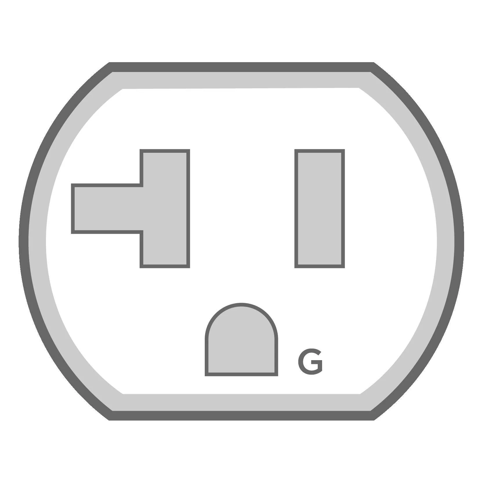

Level 2 - Slight better but still Inadequate - NEMA 5-20 - 1.92 kWh - 120 volts @ 20 amps (16 amps for charging)
(50 hours for a full charge from near zero % battery).
not much better than the NEMA 5-15 but is technically faster - 8-10 hours charging is almost 20 kWh - or about 65 miles daily driving range - again many people might have this already in their garage for an engine block heater or air compressor​
the PMCC does not come with a NEMA 5-20 adapter, and Porsche doesn't sell one - you'd have to buy an EVSE that offers this support - and by the time you're buying another EVSE - why oh why would you stop here? It's documented purely for completeness.​

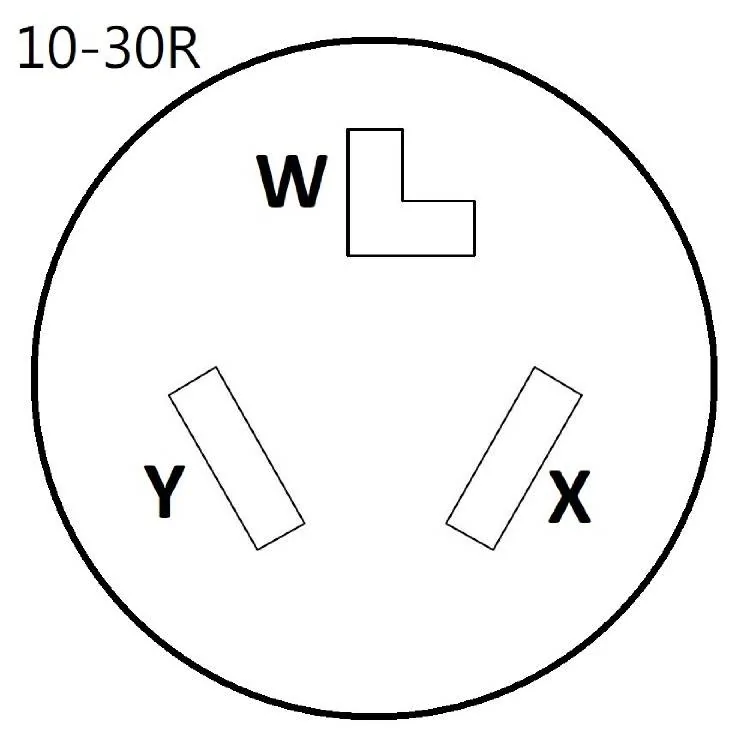

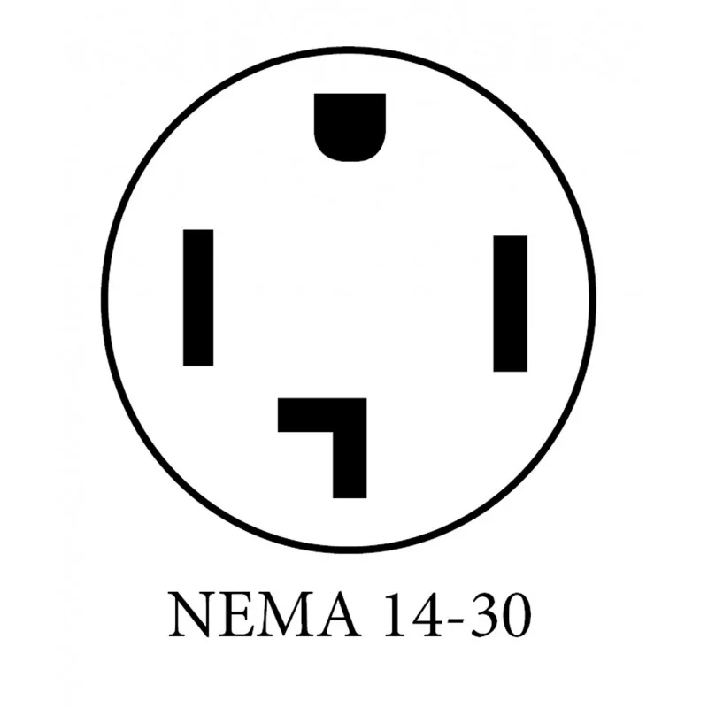

Level 4 - I have an unused 30 amp circuit in/near my garage - NEMA 6-30, 10-30, 14-30 plug 5.76 kW - 240 volts @ 30 amps (24 amps for charging)
(16 hours for a full charge from near zero % battery)​
this is the bare minimum for an EV owner in my humble opinion but honestly will do just fine for most usage. The only issue with this approach is the plug is unlikely to be well located relative to where you'd want it for EV charging and EVSE placement - still it's better than nothing and will offer a healthy 57 kWh for a 10 hour overnight charge or almost 200 miles daily driving range for a 10 hour charge session.​
Porsche sells a NEMA 6-30 or 14-30 adapter for the PMCC that comes with the car, and your electrician bill is likely to be cheap to change/move the plug. This is a great choice and if you already have one of these in the garage it certainly is going to be the cheapest option for getting your EV charging up and going.​

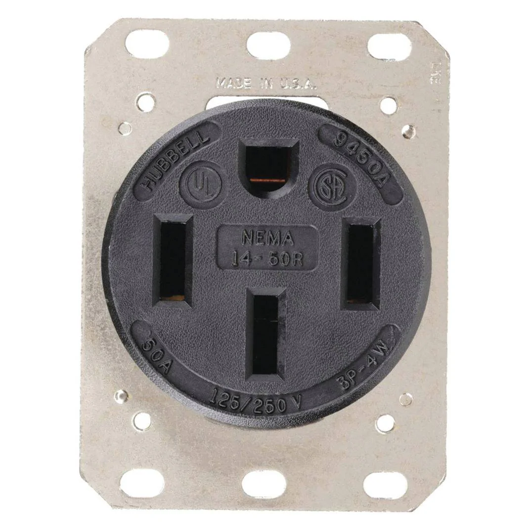

Level 5 - I have or I'm going to install a 50 amp circuit + plug - NEMA 6-50 or NEMA 14-50 - 9.6 kW - 240 volts @ 50 amps (40 amps for charging)
(11 hours from a full charge from near zero % battery)​
this is the recommend path from me and Porsche and the EV community at large - this will exploit the full power of the included Porsche Mobile Charge connect and is the largest circuit one can have installed with a mobile EVSE. NEMA 14-50 can provide a healthy 96 kWh in 10 hours of charging, which is more than the capacity of your Taycan's battery. Daily drives of up to 80 miles a day will be dispatched over night in less than 3 hours of charging time on one of these circuits. This circuit matches the Porsche North American specification for maximum charge rate and is an excellent all around choice.​
There is nothing wrong with this install and it will nearly maximize your Taycan's charging rate and for 98% of your lifetime usage it will never take more than 4 hours to charge your vehicle - this is affordable, easy, and will serve you well over the next several years.​

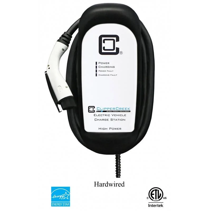

Level 6 - I read Internet forums and I know Porsche is lowballing us with the 9.6 kW specification - my Taycan can actually charge at 11 kW - 240 volts @ 60 amps (48 amps for charging)
(8.5 hours for a full charge from near zero % battery)​
it turns out the maximum charge rate for your Taycan is not 9.6 kW, but in fact 11 kW like the rest of the world. However to realize that charge rate you'll have to install a non-Porsche EVSE (no problem 100% confidence in this approach - honestly no big deal) - but the charger will NOT be mobile, it will be hardwired.​
However to realize this you need to have a 60 amp circuit installed and purchase something like a ClipperCreek HCS60 EVSE or Tesla Wall Charger Gen2/Gen3 - this will charge your Taycan at it's true maximum charge rate of ~11 kW - meaning in 4 hours of charging you can pump 44 kWh of raw unbridled power into your battery - leading to a driving range of just over 140 miles range. Your wimp-ass daily roundtrip commute of 52 miles will take a mere 100 minutes of charge time - I laugh at your charge time and think you are too much of a pretty boy to have it this good!!!​

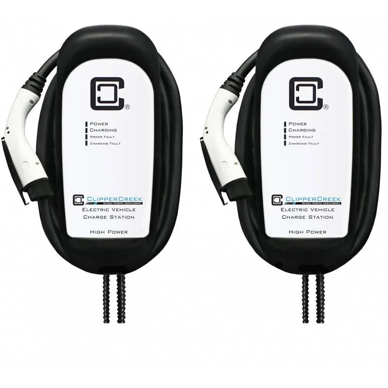

Level - ∞ @daveo4EV - how can I do more? I wish to prepare for today and tomorrow and really really want the ideal setup for my garage!!! I not only want to prepare my garage for my Taycan but I want to over prepare my garage for all future EV power options - 11 kW is good, but how can I do more? How can I prepare my garage for today, tomorrow and my eventual needs as a 1st world consumer that wants for nothing!!! I'm the type of person that must over prepare and be ready for anything!!!
Well my friends you've come to the right place :cool:. There are steps you can take to make your current EV charging scenario maximize your Taycan charging experience, but also prepare you for your glorious multi-EV future.​
  • Buy an EV with more than 11 kW charging capacity - yeah we've got you covered!
  • Need charging for multiple EV's simultaneously - yeah no problem!
  • Want to have both plug based and hardwire options for maximum ease of use and EV kingdom control - yeah this is the setup for you!
Drum roll please, :rock:this is @daveo4EV ideal over the top totally un-necessary EV garage setup plan for today, tomorrow and the future:​
  • Add a 125 amp circuit to your existing main house panel
    • Route this 125 amp circuit to a brand new 8+ slot 150 amp sub-panel installed in your garage
    • Install a 100 amp breaker as the main breaker in this new subpanel (double breakers for maximum safety, 125 amps at the main, 100 amps on the sub)
  • Install an 80 amp breaker in the new subpanel
    • off of this new shiny 80 amp breaker - install a ClipperCreek HCS80 share2 EVSE (64 amps of charging goodness for your Taycan and future EVs)
      • NOTE: this will not charge your Taycan any faster than the HCS60 - but will potentially charge future EV's faster if they can handle the raw power
      • UPDATE: MY’2021 Taycan’s and beyond have a 19.2 kW on board charging option - to take advantage of this charge rate you’ll need an 80 or 100 amp breaker and matching EVSE - 80 amp breaker = 64 amp charge rate (15.36 kW), and 100 amp breaker = 80 amp charge rate (19.2 kW)
  • Also Install a 50 amp breaker in the new subpanel
    • off of this new shiny 50 amp breaker - install a NEMA 6-50/14-50 plug for maximum easy of use, and flexibility. This plug will be there incase your EVSE is broken (wife has run over the cable and broken your plug) or just testing EV equipment for which you need a NEMA 14-50/6-50 plug handy
A nice juicy 125 amp dedicated circuit to your garage will allow for future dual 60 amp EV chargers to charge 2 EV's at 48 amp each!!! And the addition of a NEMA 14-50 for the pure convenience of having a 14-50 plug handy means that you can test, and play with various EV chargers with a minimal hassle factor. Yes my friends this is how you over do an EV charging setup. 60/80 amp EVSE from Clipper Creek & NEMA 14-50 plug for all your other EV testing/charging needs. All wrapped up in a nice tidy 100 amp sub-panel in the garage so that it's easy to change and play with your EV charging configurations to remain over the top and flexible far into the future.​
